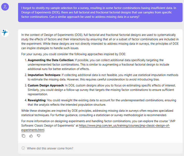

Hm, when we compare this case with DOE...
In a nicely designed DOE one doesn't even pick a (single) sample from each of the 90 subsets.
[1 sample from each of the 90 subsets: "full-factorial" -> way to "expensive"]
So, maybe together with some simplification of the model, here it's also OK to use a data set with missing entries in some intersection points? And a step further, maybe by intentionally removing (some data points from) some intersection points, one can get something useful between stratified input data and a balanced DOE?
@Victor_G might have a suggestion?
