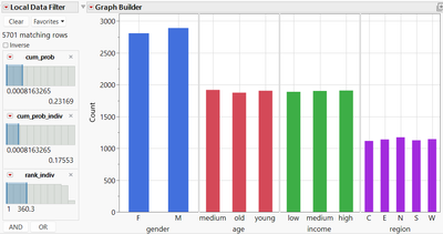

hogi
Level XIII
Re: How to Select a quota sample from a data set
For such an ideal table, (if the probabilities of your data set fit to the fractions you want), you can pick random samples - random samples per variant or a specific number of samples per variant - or a combination of all 3 ...
you will always get the subgroups with the requested fraction (1/2, 1/3, 1/3 and 1/5)

// force ratios: 1/2, 1/3, 1/3, 1/5
if(not(current data table() << has column ("rank_indiv")),
New Column( "rank_indiv",
	Formula( Col Rank( random uniform(), :gender, :income, :region, :age ) )
Graph Builder(
	Size( 518, 448 ),
	Show Control Panel( 0 ),
	Graph Spacing( 4 ),
	Variables( X( :gender ), X( :income ), X( :region ), X( :age ) ),
	Elements( Position( 1, 1 ), Bar( X,  Summary Statistic( "N" ) ) ),
	Elements( Position( 2, 1 ), Bar( X,  Summary Statistic( "N" ) ) ),
	Elements( Position( 3, 1 ), Bar( X,  Summary Statistic( "N" ) ) ),
	Elements( Position( 4, 1 ), Bar( X,  Summary Statistic( "N" ) ) ),
	Local Data Filter(
Title( "how many samples do you want ? " ), Add Filter( columns( :cum_prob, :cum_prob_indiv, :rank_indiv ) ) ) );
