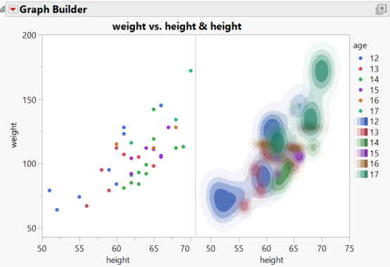

The JSL code below attempts to use the add Element method to display a Contour plot on the graph on the right side. However, because add Element is an Add Element operation, it cannot remove or replace the original Points format on the right-side graph, resulting in the generated image being different from the figure below. The original Points remain along with the added Contour. Since the X-axis can only be appended afterwards, is there any way to remove the original Points format while still using add Element?

You can remove the point element
Names Default To Here(1);
gb = dt << Graph Builder(
	Size(488, 352),
	Show Control Panel(0),
	Fit to Window("Off"),
	Variables(Y(:weight), Overlay(:age)),
	Elements(Position(1, 1), Points(X, Y, Legend(21)), Points(X, Y, Legend(23))),
		//Elements( Position( 2, 1 ), Contour( X, Y, Legend( 22 ) ) ),
gb << Add Variable({:height, Role("X")});
gb << Add Variable({:Height, Role("X")});
gb << Remove Element(2, 1, 1);
gb << Add Element(2, 1, {Type("Contour"), X, Y});
or you could build the graph builder expression to take this into account
-Jarmo

I have two questions to ask:
(1) Why are the elements (2, 1, 1) deleted twice?
The first two numbers represent the position in the graph, but I don't yet understand the meaning of the third value.
(2) From the new output graph, I noticed that the X-axis limits for X and Y are different. How can I make the X-axis limits on both the left and right sides the same automatically?

1. You have already added points to your graph even though you do not have x-axis -> you might end up with more Points graphs than you think.
Run graph builder script -> copy script
Graph Builder(
	Size(488, 352),
	Elements(Points(Y, Legend(21)), Points(Y, Legend(23)))
Run << Add Variable -> Copy script
Graph Builder(
	Size(488, 352),
	Variables(X(:height), Y(:weight), Overlay(:age)),
	Elements(Points(X, Y, Legend(21)), Points(X, Y, Legend(23)))
Graph Builder(
	Size(488, 352),
	Variables(X(:height), X(:height), Y(:weight), Overlay(:age)),
	Elements(Position(2, 1), Points(X, Y, Legend(24)), Points(X, Y, Legend(25)))
Run << Remove Element -> copy script
Graph Builder(
	Size(488, 352),
	Elements(Position(2, 1), Points(X, Y, Legend(25)))
Graph Builder(
	Size(488, 352),
	Elements(Position(2, 1))
and so on.
You can give yourself much better chance of success if you use as complete graph builder as possible
	Size(488, 393),
	Elements(Points(X, Y, Legend(2)))
gb << Add Variable({:Height, Role("X"), Position(2)});
2. You can adjust the x-axis with a script (the axis are different as contour plot needs more space than points)
	Size(488, 352),
min2 = Report(gb)[AxisBox(3)] << get min;
max2 = Report(gb)[AxisBox(3)] << get max;
Report(gb)[AxisBox(1)] << Min(min2) << Max(max2);
-Jarmo
