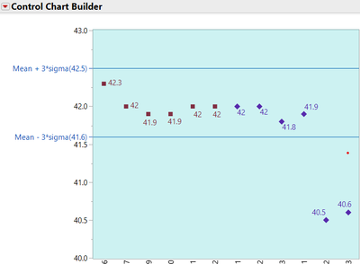

How to Increase the markers label's font size in Control chart builder?

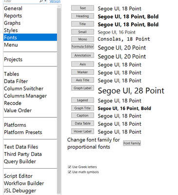

Hi @JMP_Users
Go to File>Preferences>Fonts and alter the 'Graph Label' font size to have it change:

Re: How to Increase the markers label's font size in Control chart builder?
Hi @JMP_Users
Thank You Ben..!
