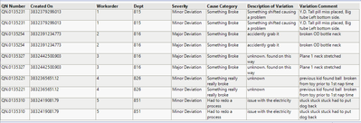

Hello everyone,
I have a script where I am trying to get the format of a column and then apply that to a textbox that is in a table box.
I tried using this  col_for=col<< Get Format; but I can't use what it returns in this loop
For Each({col_name}, column_names,
	col = Column(dty, col_name);
	col_for=(col<< Get Format);
	insertinto(col_format_text,col_for);
	insertinto(col_width,col<< Get Display Width);
	insertinto(col_wrap,col << Get Display Width);
I get an error when  I try and add the col_for into the list.
The reason I am doing this is that I am later trying to use the list to set the textbox format later with this:
		for(j=1, j<=n items(column_names), j++,
				For(i=1,i<= qty_of_rows, i++,
						col_list[j] << append(Text Box(col_var_list[j][i]),<<set format(col_format[j]),<<set width(col_width[j]), << set wrap (col_width[j]));
		tb << Set Shade Alternate Rows( 1 );
		tb << Set Row Borders( 1 );
		tb << Set Column Borders( 1 );

So where I am stuck now is the formatting of the date column. Using your help I have the script to here (haven't switched over to AA's yet) and this works great except being able to format the dates:
