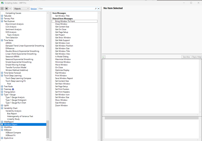

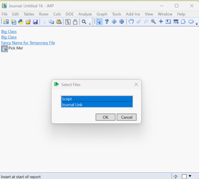

BabyDoragon
Level IV
Re: How to Implement "Saving Your Work in a JMP Journal" using JSL
I think I didn't explain the problem clearly. What I want to ask is if "add all open files" automatically sends all currently open JMP files as linked objects. However, what I want is for the user to be able to select only the desired files from these open windows, rather than adding all of them, and not using the "Add File Reference" to add saved files. As shown in the following image, I want the user to be able to select the "open file" they want to add.

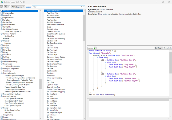

txnelson
My previous response was apparently not very clear.  My pointing yo9 to the Scripting index and the various messages that can be passed to an Outline Box is intended to point you to a good source for figuring out how to write the JSL to solve the specific requirements you have.

It also uses the Menu(1) addition to the Add All Open Files, to let the user choose the files to add

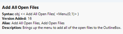

mmarchandFSLR
Level VI
It's less obvious here than in many cases, but, as Jim was alluding to, the Scripting Index does give the solution.  << Add All Open Files has an optional argument that will allow you to choose the files you want to link to in the Outline Box.
ob << Add All Open Files( Menu( 1 ) );
