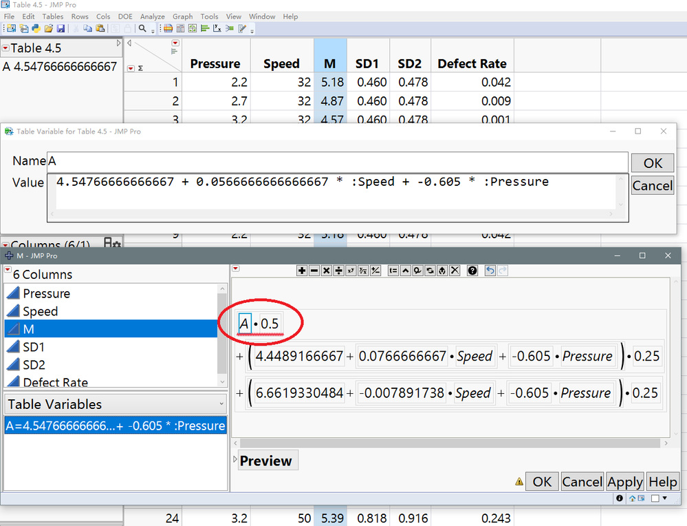

For example, in Table 4.5.jmp:
let A=4.54766666666667 + 0.0566666666666667 * :Speed + -0.605 * :Pressure,
let B=4.44891666666667 + 0.0766666666666667 * :Speed + -0.605 * :Pressure
let C=6.66193304843305 + -0.00789173789173778 * :Speed + -0.605 * :Pressure.

If you wish to repeat a formula, create a formula column and refer to that. If you wish to repeat a constant create table variable (or column with the value). To use table variable in a formula you reference it like you would a column so in this case :A

As shown in the figure, there is an error.
