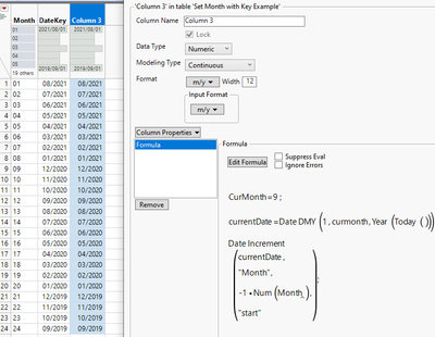

Here is one possible solution using Date Increment. Done as Formula but should be fairly easy to use in loop if you want to rename columns:
CurMonth = 9;
currentDate = Date DMY(1, curmonth, Year(Today()));
Date Increment(currentDate, "Month", -1 * Num(:Month), "start");
First curMonth is used to generate currentDate with the assumption that the start year is same as current year, then that date is used in Date Increment function.

Thanks so much, that works great!
