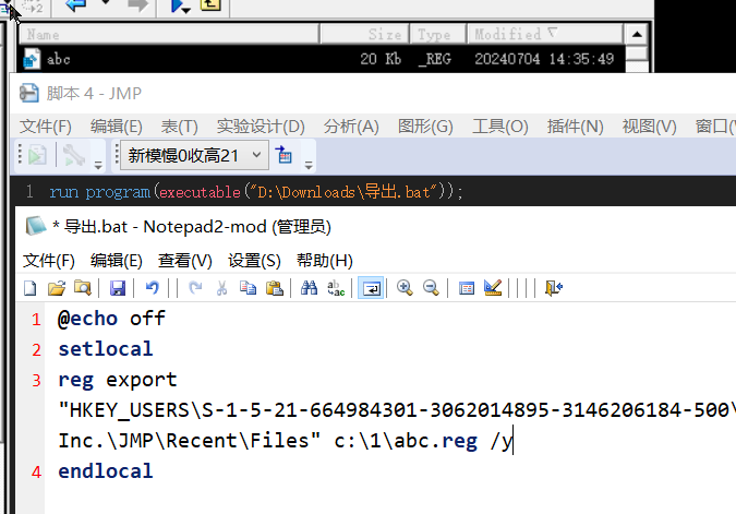

  • I am in need of how to execute this CMD command in JSL just fine.
lala
Level IX
Re: How does this CMD command run with JSL?
OK、into a BAT

lala
Level IX
  • It's a parameter issue, not a quotation mark issue.
