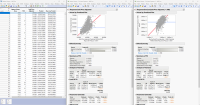

I don't know if you can read this image but you can see on the left the predicted values compared. Not fair from each other. then on the right you can see the pages for the Non BC and BC and their parameter estimates at the bottom. I can get the predicted value from the sheet using the Intercept + Estimate (X) formula given in the parameter estimates for the Non BC but not for the BC because the BC estimate is 386 Billion. That is the same number given by the python code so I can't get the accurate number shown on the left in Excel. I want to know the actual formula that JMP is using to calculate the Box Cox Predict shown on the left image.

@DWS   If I’m understanding, can’t you just save the prediction formula via the red triangle menu at the top of the output?

Re: How does JMP do BoxCox transformations?
 It still gives the 3.868e+11
