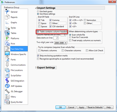

msharp
Super User (Alumni)
Re: How do you open multiple files and specify what the column names are for the files?
This is a JMP preference.  Go to File >> Preferences (ctrl+k) and uncheck the box.
Similarly you can can script this with:
Set Preferences(Import Settings(Labels(0))) //off
Set Preferences(Import Settings(Labels(1))) //on
Be sure to turn the preference back on when you are done or else you are going to annoy your end user.
