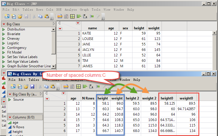

How do use JSL to quickly compare two sets of range columns in order to get the minimum of each column?
The title is a bit hard to understand.
Take this big class as an example:
1. First, summarize the average values of "height" and "weight" by age.
2. Then summarize the median of "height" and "weight" by age.
3. Then compare the mean and median of "height" and take their minimum.
Finally, compare the mean and median of "body weight" and take their minimum.
I'll use the following code and finally loop through to get the minimum.
Is there any good code that minimizes this comparison?
d1 = dt << Summary(
	Group( :age ),
	Mean( :height ),
	Mean( :weight ),
	Median( :height ),
	Median( :weight ),
	Freq( "None" ),
	Weight( "None" ),
	Link to original data table( 0 ),
	statistics column name format( "column" )
c = N Col( d1 ) / 2 - 1;
For( i = 1, i <= c, i++,
	ca = Column( i + 2 ) << Get Name || "0";
	d1 << New Column( ca, formula( Min( As Column( 2 + i ), As Column( 2 + c + i ) ) ) );
	d1 << run formulas;
	Column( ca ) << deleteFormula;
Thanks!

lwx228
Level VIII
Re: How do use JSL to quickly compare two sets of range columns in order to get the minimum of each column?
This looping method is slow when the number of columns and rows that need to be summarized for comparison is large.
Is the matrix method faster?Or there are other good ways.
