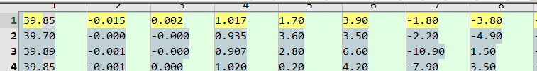

How do make a table out of a string like this?
Thanks!
data<=>39.85,-0.015,0.002,1.017,1.70,3.90,-1.80,-3.80,-0.28,-12257.23,15:00,218879.08|39.70,-0.000,-0.000,0.935,3.60,3.50,-2.20,-4.90,-0.65,-357.77,09:30,5039.02|39.89,-0.001,-0.000,0.907,2.80,6.60,-10.90,1.50,-0.18,-882.37,09:32,9386.96|39.85,-0.001,0.000,1.020,0.20,4.20,-7.90,3.50,-0.28,-505.97,09:33,11499.35|

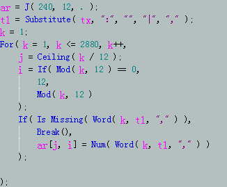

off1 = Contains( txt, "data<=>" );
If( off1,
txt = Substr( txt, off1 + 1, Length( txt ) )
off2 = Contains( txt, "|", -1 );
If( off2,
txt = Substr( txt, 1, off2 )
t1=Substitute(txt,":","",","," ","|",",");

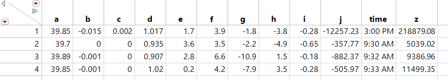

Another approach. If you don't know the column names, you can leave out the columns(...) section.
txt = "data<=>39.85,-0.015,0.002,1.017,1.70,3.90,-1.80,-3.80,-0.28,-12257.23,15:00,218879.08|39.70,-0.000,-0.000,0.935,3.60,3.50,-2.20,-4.90,-0.65,-357.77,09:30,5039.02|39.89,-0.001,-0.000,0.907,2.80,6.60,-10.90,1.50,-0.18,-882.37,09:32,9386.96|39.85,-0.001,0.000,1.020,0.20,4.20,-7.90,3.50,-0.28,-505.97,09:33,11499.35|";
Open(
    Char To Blob( Munger( txt, 1, "data<=>", "" ) ),
    columns(
        New Column( "a" ),
        New Column( "b" ),
        New Column( "c" ),
        New Column( "d" ),
        New Column( "e" ),
        New Column( "f" ),
        New Column( "g" ),
        New Column( "h" ),
        New Column( "i" ),
        New Column( "j" ),
        New Column( "time", Informat( "h:m" ), Format( "h:m" ) ),
        New Column( "z" )
    Import Settings( End Of Line( Other( "|" ) ), Labels( 0 ), Data Starts( 1 ) )
This is the first time I've used munger() and felt good about it. It looks like its failure behavior (if the data<=> text changes) will be reasonable...leaving the text as is and adding it to the first value.
Opening a blob of CSV-like data using | for line end characters.Opening a blob of CSV-like data using | for line end characters.
The open() function accepts a blob instead of a filename; the import settings() tells it to expect something like a .txt or .csv file in the blob.
