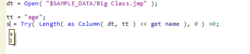

Re: How do know if the list of column names in a data table contains a variable?
