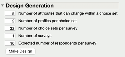

Perhaps I have misunderstood. But if you go through the design generation process:
then all of the choice sets are equally important in gathering the data required to fit the specified model. So what, exactly, do you mean by 'the best 4 out of the 32 choice sets', please?
