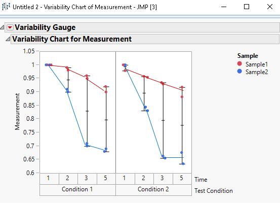

If i have several samples I want to group by the sample and draw a cell means and bars for each sample.
Here's an example that JMP generates:
It's just plotting one cell mean, but I want to draw separate cell means grouped by each sample individually.
Seems like it's impossible to do that right?

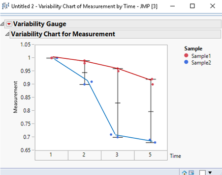

This is what I want to be able to do:

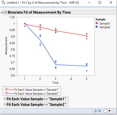

I know I can do something like this using the bivariate chart:

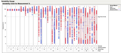

But what if I want  to do something like this:
Seems like JMP is only allowing me plot this:

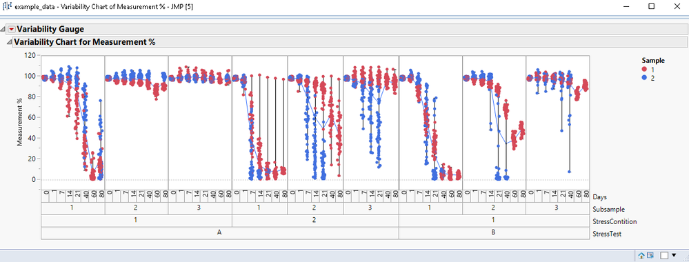

The graph it's generating is exactly what I'm looking for in terms of the visual aesthetics, except that I want it to be able to draw the range bars and the connected cell means for each sample individually (i.e. for sample 1 & 2).
If it's not possible to do what I want using the variability gauge chart, then how do I replicate the same visual aesthetic of multiple charts side by side with one axis on the left side with all of the same labels on the bottom using something else?
I'm open to any suggestions.

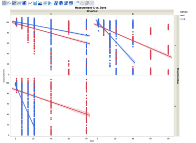

One example what could be done in Graph Builder:

Still not sure what you mean by range bars?  The way you have displayed the data is as individual data points.  There are no ranges.  If you want the range of one of your components, you need to leave it out of the plot (if you want the range of subsamples, leave it out and select the box plots option for variability charts, see below)  If you leave sample out of the variability plot and do the plots by sample, then you can get the cell means for each sample (I added those scripts).  Also, the arrangement on your variability plot does not look hierarchically correct?  Days can't be nested in sample?  But I don't know the points you are trying to make with your plots.
 I don't think JMP 13 has the capabilities of graph builder that are available with JMP 16.  Here is an example of JMP 16 graph builder output:
