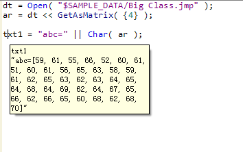

How do combine numbers in a column with other literals to form text characters?
ar = dt << GetAsMatrix( {4} );
txt1 = "abc=" || Char( ar );
I use the above code does not match, much []
What I need is the following result:
Thanks!
txt1 = "abc=59, 61, 55, 66, 52, 60, 61, 51, 60, 61, 56, 65, 63, 58, 59, 61, 62, 65, 63, 62, 63, 64, 65, 64, 68, 64, 69, 62, 64, 67, 65, 66, 62, 66, 65, 60, 68, 62, 68, 70"

If you know it's just going to be a matrix, you could just lop off the [].
txt1 = "abc=" || Substitute(Char( ar ), "[", "", "]", "");

Apparently the JSL parser is forcing the numerics into a matrix.  I suggest you turn the issue into JMP support for their feedback.  In the mean time, here is a workaround:
names default to here(1);
// Open Data Table: big class.jmp
// → Data Table( "big class" )
ar = dt << GetAsMatrix( 4 );
txt1 = "abc=" || char(ar[1]);
for(i=2,i<=nitems(ar), i++,
	txt1 = txt1 || ", " || char(ar[i])
show(txt1);
Jim
