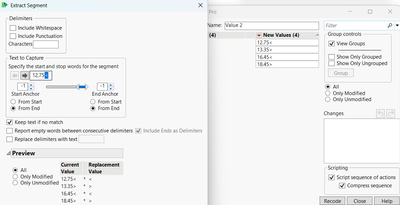

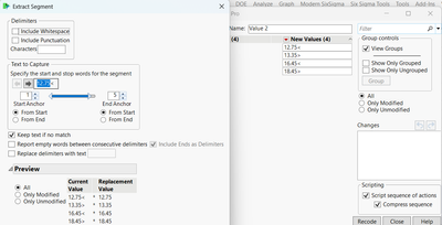

You could use the Recode Data in a Column option to extract segment, or use column formula :
- Settings to extract the value :
Or formula :
Word( [1 5], :Value, "", Unmatched( :Value ) )
- Settings to extract the sign at the end :
Or formula :
Word( -1, :Value, "", Unmatched( :Value ) )
