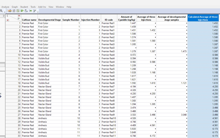

How do I use a formula to calculate mean for selected rows
Hi everyone,
To preface, I am basically a new user to JMP so I don't know how to do any scripting.  Just basic formulas, etc.  Here is what I need to do and can't figure out how.
I'd like to first calculate an average of the "Amount of Cyandin" for each of the same "Sample Number" (goal to have a column that calculates what I've placed in the "Average of three injections" column.
Similarly I'd like a column that gives the average of those three averages for each "Development Stage" which I've placed the goal in the column labeled "Average of developmental stages"
It's not a moving average... I thought maybe a conditional statement in a formula would work? Or perhaps a formula that uses some kind of third column like the "ID Code" column as an identifier to tell it which rows to average?
Thanks!

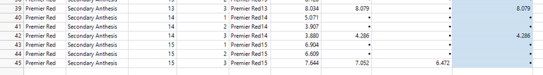

EmilyT
Level II
Re: How do I use a formula to calculate mean for selected rows
Thank you very much.  I think I've figured it out now thanks to your explanations!
