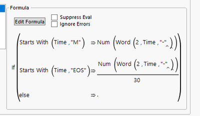

I see other similar ideas, attached is mine (without scripting).

jthi
Re: How do I transform a time data column (nominal) into continuous data in one unit (months)?
You don't need to store it in a variable.
Example below. Run the script and check the formula for MonthNumber:
Names Default To Here(1);
dt = New Table("Untitled",
	Add Rows(4),
	New Column("Time", Character, "Nominal", Set Values({"M-12", "M-36", "EOS-968", "EOS-1011"}))
dt << New Column("MonthNumber", Numeric, Continuous, Formula(
	If(StartsWith(:Time, "M"),
		Num(Word(2, :Time, "-"))
	StartsWith(:Time, "EOS"),
		Num(Word(2, :Time, "-"))/30
		. //if starts with something else than "M" or "EOS"
You can then modify the formula as required.
-Jarmo
