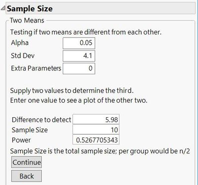

Re: How do I set up a prospective power calculation?
The issue is your sample size. If n=5 for each group, your total sample size is 10. JMP is looking for total sample size, and assumes the samples are equally distributed between the two groups (or as close to it as you can get).
If you have a situation where you want unbalanced samples, then you do go with the "mock data" approach, which makes sense. If you are using a sample size calculator to plan data collection, you should plan on balance -- a desirable property.
Oh, and as @Thierry_S pointed out, there is a spot to get sample size and power. Using that dialog, I chose Two Sample Means, entered your information and get this result which matches the other packages.
