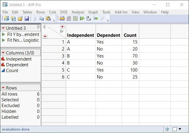

You can analyze such data with the Contingency platform and the Nominal Logistic platform, but neither one provides such post-hoc tests as you describe. There is the Odds Ratio for Independent report that might be useful. Here is a mock up of your study:

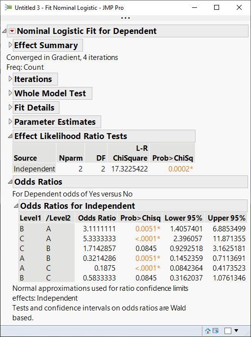

Here is the platform:
It is generally better not to divide the data up for separate tests. It reduces the power of the tests.
I do not recommend the Response Screening platform. It is generally intended to screen many response. The FDR in particular is an adjustment for very large tests and should not be used otherwise.
