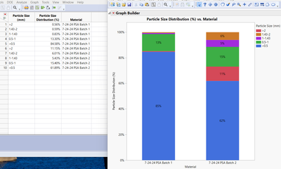

How do I reorder the data categories in the bars to match the legend?
I want the data displayed to be in numerical order with <0.5 at the bottom. I found an old post about this but it's outdated so the feature isn't available anymore.

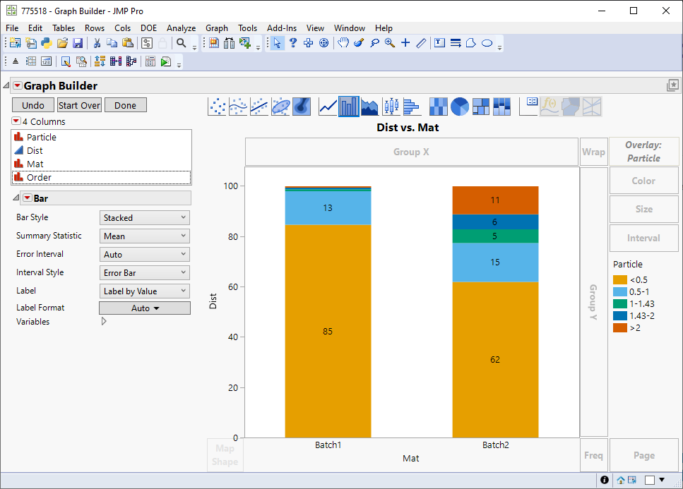

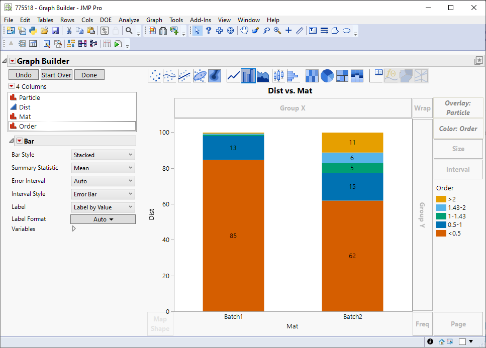

jthi
Re: How do I reorder the data categories in the bars to match the legend?
You can force JMP to workaround the reverse ordering by adding value order to your overlay column, duplicating overlay column, setting it to have reversed value order and using that as color (or do it by reordering like Jim suggested)
With the double column
Data table attached.

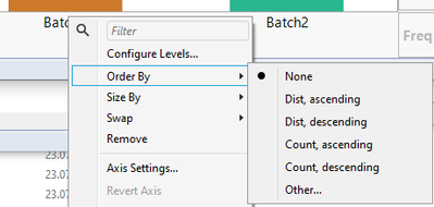

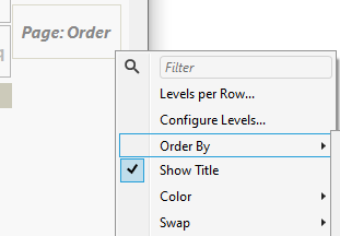

Interesting:
Half of the Drop Boxes in Graph Builder have a "order by" menu: Axes, X/Y group, wrap, Page ...
the other half doesn't have this option:
