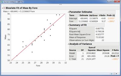

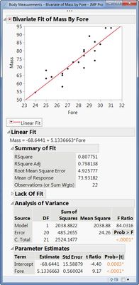

Compare these two layouts of JMP results.  The one on the left is the report window, the one on the right is a Journal that I have rearranged the output into a more "rectangular" and wider view.  Most displays are wide, not tall, and JMP reports tend to be tall, not wide.   In addition, I've change the order of some of the content and deleted things that I don't want to show.
