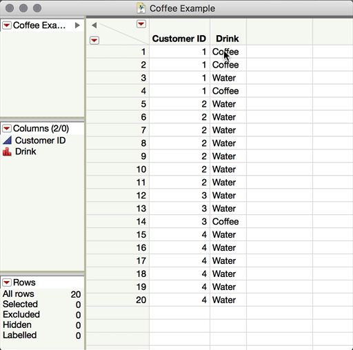

Another method which works well for the case of selecting on the basis of just one item, is to utilize the Right Click > Select Matching. First, select a cell with coffee, right click > select matching, which selects all the coffee cells in that column. Then, click the customer ID column, and right-click an already selected cell > select matching. This will now select all those customers that had been selected because they had purchased coffee. You can now delete those rows and you're left with the subset of customers who never purchased coffee.

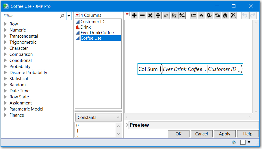

Another method that users seem to like is to create a new column in your data table, that has a formula for specific criteria. In this case, a column sum aggregated by customer ID will find out the count of Coffee Use. Then use Select Where or Select Matching Cell where the Coffee Use  == 0. The column can be used for data filters etc.
