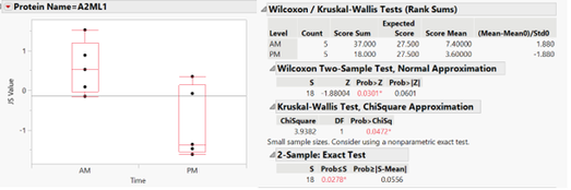

To find Z-scores for the Intraday dataset, I input the "Intraday" data, in the attached excel below, into JMP. The JS value is Johnson transformed values for normality. I then followed these steps:
  • Take Johnson Transformed Data --> Fit Y by X --> Y = JS value, X = time, By = Protein Name --> Get graphs --> Red Triangle --> Nonparametric --> Exact Test --> Wilcoxin Exact Test
  • My data looked like this:

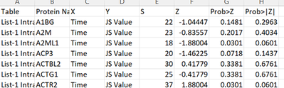

  • From there, I did: See Wilcoxin 2-sample test, normal approx. --> right click --> Make combined table --> See z-scores --> Paste into Excel
  • Then my data looked like this:
  • Here are some of the z-scores for the Intraday data under the "Z" tab.
