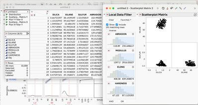

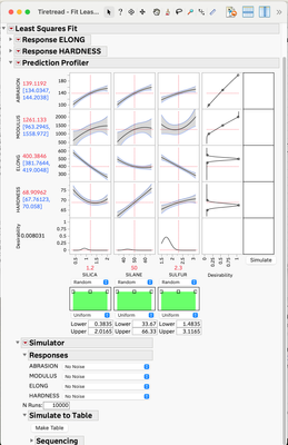

  1. Create an output table of simulated results, randomly or systematically choosing input values and filter that output.  Sometime we call that approach Monte Carlo Filtering.
    Run the "Plot X filter Y" script saved to that table.  Turn on the profiler simulator, set the input variables to have random uniform distribution, and then simulate to a data table.

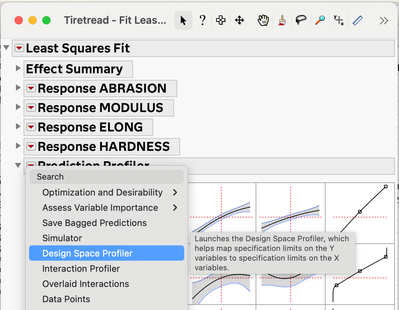

  2. Use the Design Space Profiler
    which is described in more detail here https://community.jmp.com/t5/Mastering-JMP/Maximizing-Quality-Using-Design-Space-Profiling/ta-p/6144...
