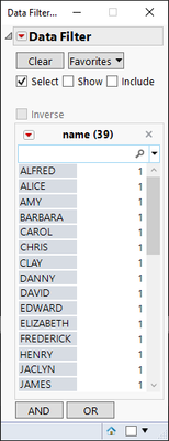

jthi
Re: How do I get a list from an SQL query and let the user select the option from the list?
You can maybe use just data filter
or build some more customized U using different options such as list box, check box, radio box...
