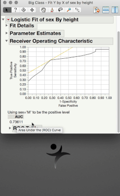

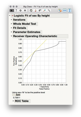

1. Fit a classifier model. I'll be using Big Class, and will predict sex by height. Reveal the AUCroc from the Red Triangle.1.png

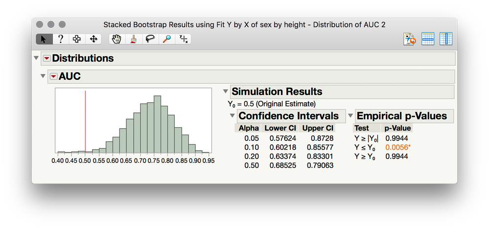

3. Analyze > Distribution, then put AUC as Y, and check "Histograms only," then click OK:
You now have the bootstrap confidence limits on AUCroc, which are great for reporting, plus if you wish to know whether your originally obtained AUCroc is different from a particular value, you just need to see whether that null value is within the confidence interval at your chosen level of confidence.

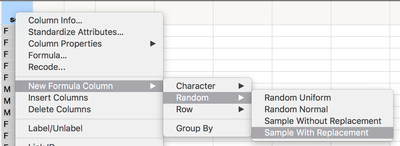

Another way (and frankly, the better way) we could have gone about this if an empirical p-value is our desired outcome, is using Right Click > Simulate on the reported AUCroc. Much like Bootstrapping, we will involve resampling with replacement from our table (or without replacement if we wish to do a permutation test). In order to do this as a Right Click > Simulate, we need to create a new formula column for the simulator that will handle the sampling with replacement. A simple way to do this is to select the Y column in your table, right-click the header row > New Formula Column > Random > Sample with Replacement. swr.png
This makes a new column (Resample[sex]), and every time the formula for this column is rereun the labels of M and F are randomly assigned to the table based on the observed base rates (i.e., sampling with replacement).
