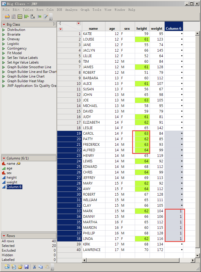

How do I determine whether the data in the specified range meets the criteria?
For example, find the height column with four consecutive rows between the top 10 rows and the top 20 rows >>60 and <65.

Re: How do I determine whether the data in the specified range meets the criteria?
Sum(
	60 < height[Index( Row() - 19, Row() - 10 )] < 65 &
	60 < height[Index( Row() - 18, Row() - 9  )] < 65 &
	60 < height[Index( Row() - 17, Row() - 8  )] < 65 &
	60 < height[Index( Row() - 16, Row() - 7  )] < 65
