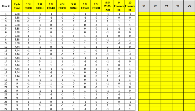

I am trying to create a fractional factorial balanced DOE matrix with 11 3-level factors and 27 conditions and 4 replicates per condition (5 runs per condition). How do I go about doing this in JMP 16? I tried using a custom design and specifying "4 replicates" and "135 runs" but I am not getting a matrix with replicates. Instead, I am getting 135 different runs. Below is the DOE data table I want to generate with 5 runs for each of the 27 conditions.

Thanks for the clarification. If I use the custom design option and create the 27 run design (which does not match my reference design shown above), can I change the values of the factors based on my reference matrix above and retain all the functionality of the built-in DOE model evaluation?

Looking at your coded matrix, it's hard to tell which type have the different factors (all continuous, or some categoricals ?), and so to give you advice for the design creation. Note that if you have the matrix in Excel file, you can simply import your file and then add manually properties to the different factors column (Coding, Design Role and Factor Changes for continuous factors) to make JMP understand this is a DoE (even if the model will not be pre-specified and will have to be specified in the analysis through the platform "Fit Model").

  • In case of only continuous factors and looking at your matrix, this design doesn't look like a typical fractional factorial design, as you seem to have three levels for all factors; "traditional" fractional factorial designs have 2 levels (one high, one low). Which design did you use ? What are the model terms ?
  • Do you have constraints in your design (blocking factor or hard to change factor) ? It seems Cycle time (first factor of the DoE ?) has some constraints on randomization, so if it's the case, you can specify it during the Custom DoE creation (creating blocking Factors (jmp.com), Group runs into random blocks of size (Design Generation (jmp.com)), or setting some factor type as "Hard to change" to specify a constraint on randomization (exemple here : Example of the Factor Changes Column Property (jmp.com))

Thanks for the detailed explanation. All my factors are categorical with three levels and identical cycle times were put together for ease of conducting the experiments. I asked Dan as well, but when I do a custom design like Dan suggested, a matrix which is not the matrix I want is generated. Could I simply change the entries in the generated data table to match my desired matrix and have the built-in DOE evaluation script run accurately?

JMP will build the design you want. The design is available in one of the older DOE platforms. Select DOE > Classical > Two-Level Screening > Screening. Define your 11 factors as Discrete Numeric with 3 levels. Click Continue and select the first radio button (fractional factorial), which is the default choice.
See this documentation and read about Placket-Burman designs.
Please see the important advice offered here. A successful experiment is more than how the design is made.
Here is an example with 11 factors with 3 levels. It is a P-B L27 design. Use the DOE Dialog table script to start at the beginning of the design process.
