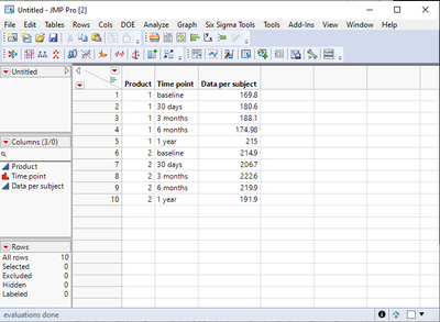

  There's a few different ways you can do this. Ultimately, you'll want to do a conditional formula based on the values of the baselines. However, your data table is not setup like it really should be for JMP. Looking at your columns, it looks like you should also have another column, maybe "product" or something like that since your "time point" column repeats some entries with a new baseline value. Something like below:

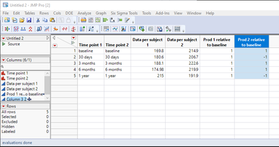

  You would then want to split your data table using the Product column and split the other two columns. The new table will look like the one below.

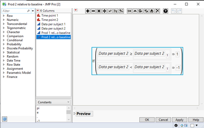

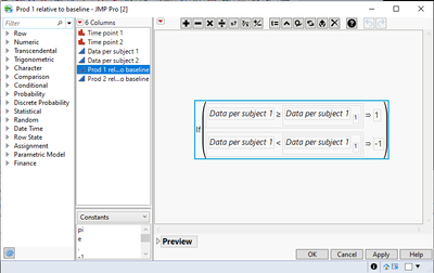

  The last two columns in this table are formulas that use a conditional IF statement. Each one references the first cell (baseline) for each "product". To reference a specific cell of a column, after the column name type [], left square bracket followed by right square bracket. You'll then put 1 in there for the first cell of the respective column.
 These formulas are set to return a numerical value -1 for below the baseline, 1 for above the baseline. You can change this to whatever you want, text or 0/1 or whatever.
