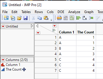

Here are a couple of ways to handle this
Names Default To Here( 1 );
dt = Current Data Table();
For Each Row(
	If(
		Row() == 1, count = 1,
		:column 1 != Lag( :column 1 ), count
Show( count );
// Look in the log for the value of count
// or
dt << New Column( "The Count",
	formula(
		If(
			count;
Jim
