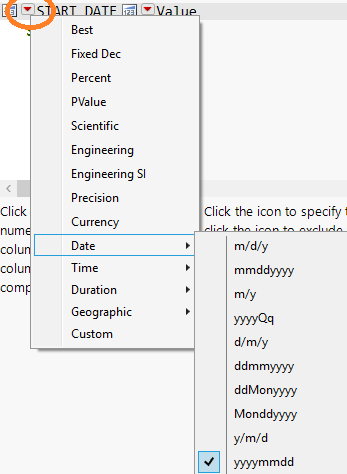

and set the column's format
Output format different from input formatOutput format different from input format

When you imported this data into JMP, possibly from a CSV file, or when you typed it in to a fresh table, JMP saw a number and made a numeric column. To make JMP see a date in 20180315 rather than 20,180,315 you need to tell JMP to interpret the data as yyyymmdd format. You can do that with the column proerties in a data table and specify both the informat and the format.
 informat yyyymmdd format monddyyyyinformat yyyymmdd format monddyyyy
Input Format available after choosing FormatInput Format available after choosing Format
