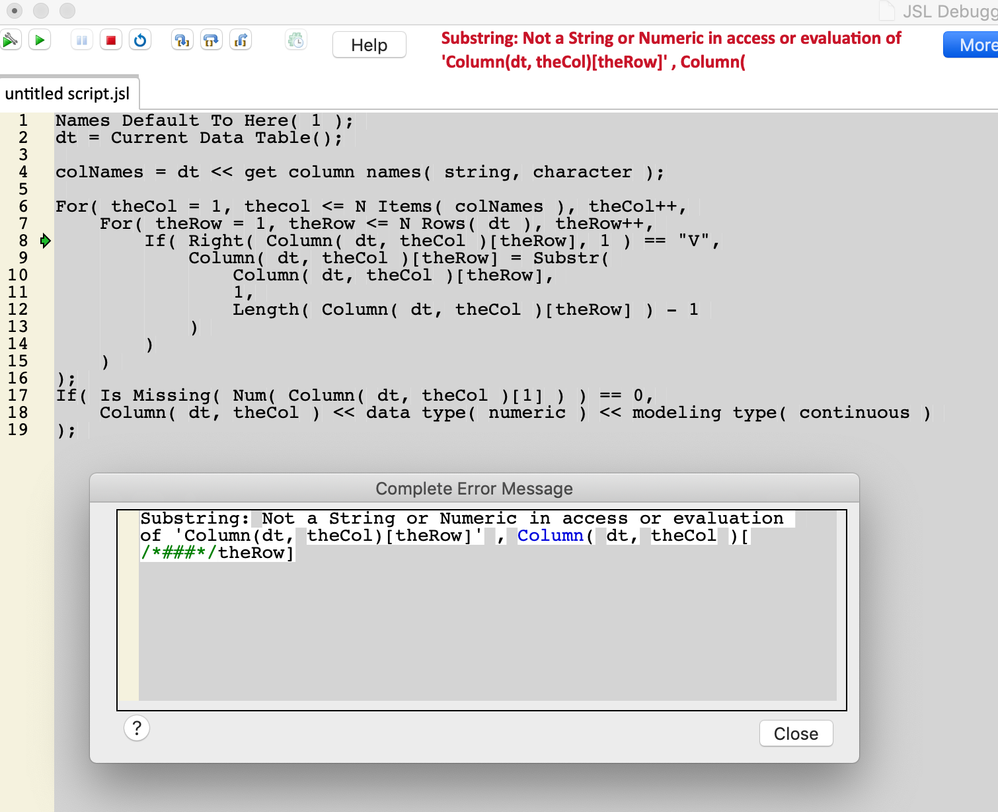

jpmontagne
Level III
Re: How do I code find & replace in JSL, to remove text from a column & convert to number format.
Hi Jim, your code didn't quite work, and I couldn't figure out why. I've uploaded a screenshot of JMP's debugger with the error message, and a subset of my data if you'd like to continue tackling this. I'd be very interested in this alternative solution!

txnelson
I did find a logic error in my code.  Below is an example data table with a small script that converts the values in place.
