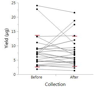

I'm new to JMP, and trying to determine which test is appropriate for my study. I have matched biological measurements at two time points (before and after a meal) for 25 individual donors. Each donor has a single data point per time point. The population has a large standard deviation for most of these measurements, and usually the results do not have a normal distribution. Some observations have a few outliers. I have attached a sample graph depicting my data.
Is it appropriate to analyze the data with a simple t-test or Wilcoxon test via the Fit Y by X menu? Or should I perform the analysis using the Specialized Modeling > Matched Pairs > Wilcoxon Signed Rank approach? The main question in this study is whether or not the biological measurement (ie, yield) changes after eating a meal. I'm not particularly interested in donor-specific responses, more the trend of the population as a whole. Any advice on which test to use, and how to execute that test in JMP, would be greatly appreciated!

Yield, before and after a meal. Each dot represents one donor, line connecting donor yield before/after. Red lines indicate SDYield, before and after a meal. Each dot represents one donor, line connecting donor yield before/after. Red lines indicate SD

Maybe I'm misunderstanding, but if your question is "The main question in this study is whether or not the biological measurement (ie, yield) changes after eating a meal."  Wouldn't you really want to compare the delta between before and after, not before vs after?  While your sample data may be non-normal (it looks like a gamma distribution to me), your delta distribution is most likely normal with a more reasonable std deviation.  Assuming this is the case you could just test the delta distribution mean against the null hypothesis that it's mean is 0 (or there are no changes after eating a meal.)
