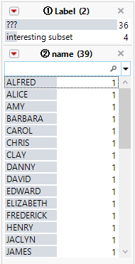

Makes more sense if :sex is replaced with a :label column.
The idea:
pre-define the order of the conditional data filter (use :label as pre-selection and let it determine which entries show up in the :name filter; like the hierarchical Filter in a dashboard),
without selecting anything in local data filter:
The workaround: set some filter and clear the selection
View more...
