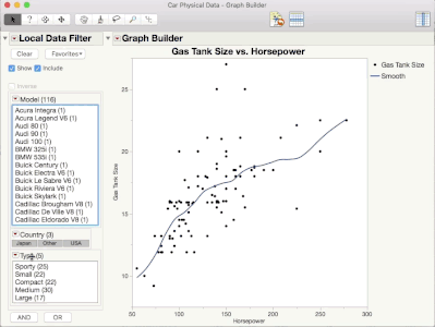

The conditional order is determined by the order the columns are used in the filter, not the order they are displayed. If you're working interactively that's the order you make selections in each column. If you're working JSL, it's the order they appear in the script.
Interactively, after adding all of your columns to the filter and turning on the Conditional option, the first column you make a selection in will be marked with a [1] and the other columns will show only values within that selection. The next column you make a seleciton in will be marked with [2], and so on. You can reset the order by clicking the Clear button at the top of the data filter and then starting your selections again.
If you're doing this with JSL, it's the order they appear in Where() clauses.
