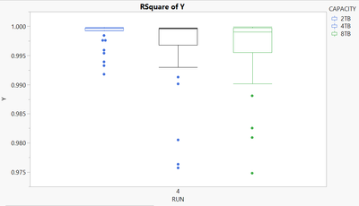

I am trying to change the second item in the legend to be black instead of red.
Inside of my graph builder function I use the following line of code to do this. (line color 0 = black)
Dispatch( {}, "400", ScaleBox, {Legend Model( 3, Properties( 1, {Line Color( 0 )}, Item ID("4TB", 1 ) ) )} )
This is how my plot turns out:
The box plot turns black, but the legend is blue, and the outlier data points are blue. They should be black.
Am I missing an extra line of code to change the data points to be black?
Thanks for the help!

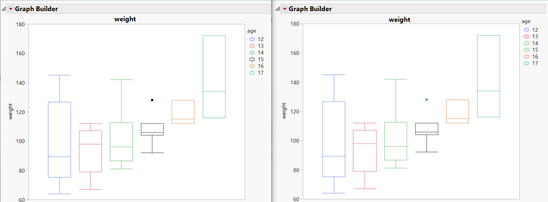

I realized that it is another problem. I can make the graph as @Mark_Bailey suggested by saving the script and running that. But when I save as journal and open it the plot has the wrong color.
On the left I have the plot I created with age = 15 set to black.
On the right is the same plot but it has been saved as journal and opened. Now age = 15 has a green data point that should be black.
Thanks,
