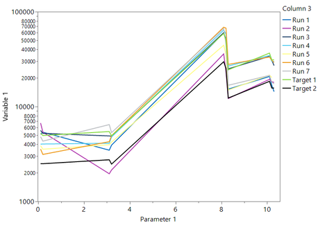

How do I add shading Between Targets with Run Lines over top?
Hi JMP Community,
I've caught myself in a bit of a pickle trying to figure this out. I have a set of run data from 6 different runs that I'd like to plot as a line graph over the shaded area between our targets. Could someone explain how to do this? If it's possible. Below is the data and targets (lime green and black) that I have and I'd like to shade the area in light grey between the two target values and possibly remove the lines for the targets if that's possible.
Thank you!

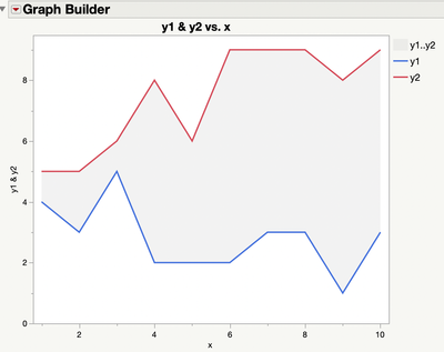

You might be able to use the 'Area' element in Graph Builder with style 'Range'. For example:
NamesDefaultToHere(1);
n = 10;
dt = NewTable("Two Traces",
		NewColumn("x", Numeric, Continous, Values(Transpose(Index(1, n, 1)))),
		NewColumn("y1", Numeric, Continous, Values(J(n, 1, RandomInteger(1, 5)))),
		NewColumn("y2", Numeric, Continous, Values(J(n, 1, RandomInteger(5, 10)))),
gb = dt << Graph Builder(
				Variables( X( :x ), Y( :y1 ), Y( :y2, Position( 1 ) ) ),
				Elements(
					Area( X, Y( 1 ), Y( 2 ), Legend( 7 ), Area Style( "Range" ) ),
					Line( X, Y( 1 ), Y( 2 ), Legend( 8 ) )
				SendToReport(
					Dispatch(
						"400",
						ScaleBox,
						{Legend Model(
							7,
							Properties(
								0,
								{Fill Color( 32 ), Transparency( 0.2 )},
								Item ID( "y1..y2", 1 )
