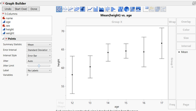

You can either turn on Summary Statistics in Bivariate or use Graph Builder and add the Caption Box from the top ribbon and enable mean and stdev to get the values.
If you want to visualize stdev as error intervals, use Graph Builder and from the Points options set summary statistic to mean and error interval to standard deviation.

Not in Bivariate, but if you make your X variable (time point) into an ordinal modeling type, which would turn the Bivariate into a Oneway analysis, then you can turn it on from the Oneway red triangle Means and Std Dev.
