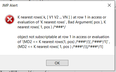

Additionally, when I run my version ( reading the tables with four columns ( x, y, data 1, data 2) on Table 1 and ( x2, y2, data 3, data 4)) I get the below alert . I think it is upset because the Table 1, and Table 2 have more than two columns (x, y) which are not in the matrix. But if you explain the line, I think I can figure out the rest! Thanks for the help

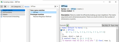

VPTree:
For K nearest Rows there is no real documentation in the Scripting INdex, but there is an example right in the definition of VPTree:

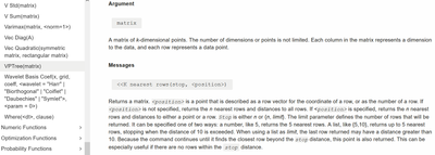

and there is some documentation in the online help:
sounds like the same 2 options as for KDTable.
From @jthi 's example you can see that VPTree allows a third mode, where a set of positions is provided as a matrix.
This is a bit surprising, but very convenient :)
tree = VPTree(m2);
{rows, distances} = tree << K Nearest Rows(1, m1);
dt1 << New Column("Nearest", Numeric, Ordinal, Values(rows));
