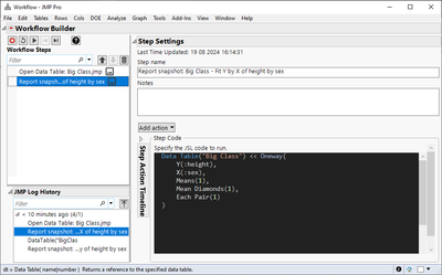

Doesn't that script include all of those (Means(1) and Each Pair(1))?

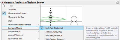

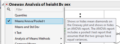

I assume when you are recording the workflow, you will also select correct things from fit y by x platform? So you select Means
and means comparison

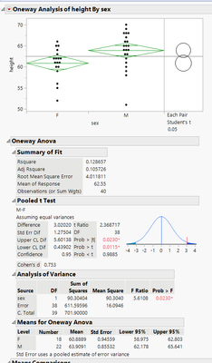

So you get report like this
when you close the report it should be recorded

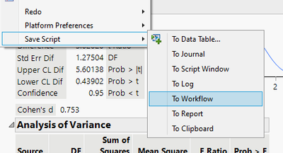

Other option is to Save Script to Workflow (this way you don't have to close the report window)
