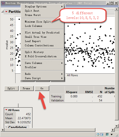

How do I add R squared to control the Partition in the decision tree code?
In the case of Boston housing.jmp, adjust the parameters of "Minimum Size Split" and "Split Best" in the JSL code to control the automatic Partition of decision tree.
Partition(
Y( :mvalue ),
X( :crim, :zn, :indus, :chas, :nox, :rooms, :age, :distance, :radial, :tax, :pt, :b, :lstat ),
Validation Portion( 0.3 ),
Minimum Size Split( 2 ),
Split Best( 1000 )
However, the R square of the validation group is <0 after the above code calculation.
Normally, in the decision tree model where verification group is performed on the Partition platform, the Partition will be automatically stopped before R square <0 of the verification group.
It looks like I'm going to add to my code to verify that the group R squared stops splitting, but I have no idea how to do that.I only found the manual.Thank you!

Consult a professional: how do I write code that makes JSL's results the same as the decision tree Partition results that are automatically executed on the platform?Thank you very much!
