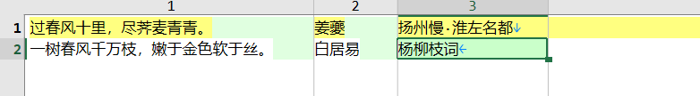

How can use the regex substitution <*>?
How to use regex to replace the text of dt[1,"A"] with tabs for each <*>.It get the multi-column result in row 2.
Thanks!
