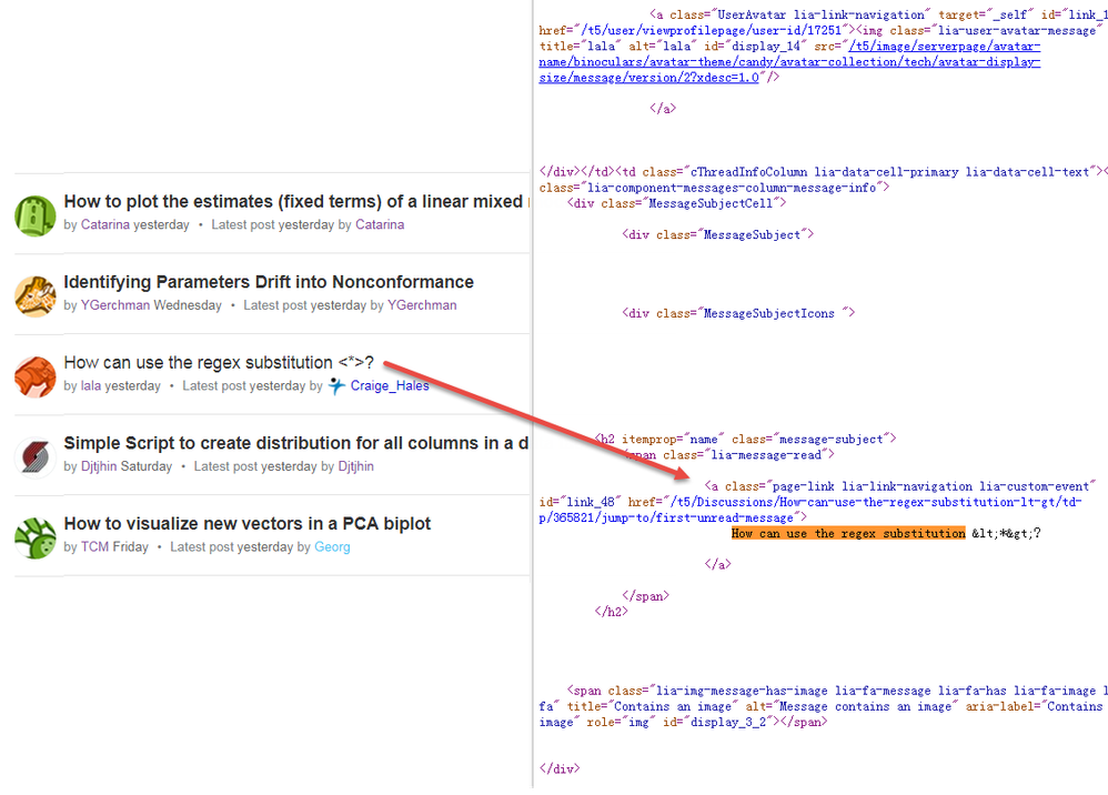

How can use the regex substitution <*>?
How to use regex to replace the text of dt[1,"A"] with tabs for each <*>.It get the multi-column result in row 2.
Thanks!

I want to use JSL via JMP directly to get the title of the page and link list.
For example: this JMP community web page,
  • I'll try to write it this way. But it didn't work.
  • Thanks!

rc = patmatch( txt,
	patrepeat( // repeat the pattern until no more
		(linkpat + pattest(// run some JSL for the linkpat...
			desc = Regex( desctext, "<[^>]*>", "", globalreplace ); // remove span, etc tags
			hreftext = Regex( linktext, "href\s*=\s*(\!"|')(.*?)(\1)", "\2" );//
			if( !Is Missing( hreftext ), //
				dt << addrows( 1 );//
				irow = N Rows( dt );//
				dt:link[irow] = hreftext;//
				dt:description[irow] = desc; //
			1; // pattest needs this to succeed
		)) | scriptpat /* maybe skip a script */ | /* maybe skip to the next tag */ (Pat Len( 1 ) + Pat Break( "<" ))
	NULL,IGNORECASE
stoptime = Tick Seconds();
dt << endDataUpdate;
Show( stoptime - starttime ); // .5 sec, 128 links
Show( rc ); // should be 1, not 0

Craige
Craige_Hales
Re: How can use the regex substitution <*>?
ignore the .5 sec, # links comments in the JSL. Run your own test.
Comments quickly go bad, especially when copy/paste!
Craige
