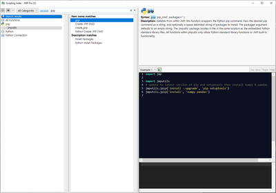

Re: How can the following python library installation commands be implemented in python in a JMP environment?
Have you tried with the extra commands? The first argument in jpip should allow you to use something like
'install -i https://pypi.tuna.tsinghua.edu.cn/simple'
inside it (scripting index has example of using install --upgrade)
-Jarmo

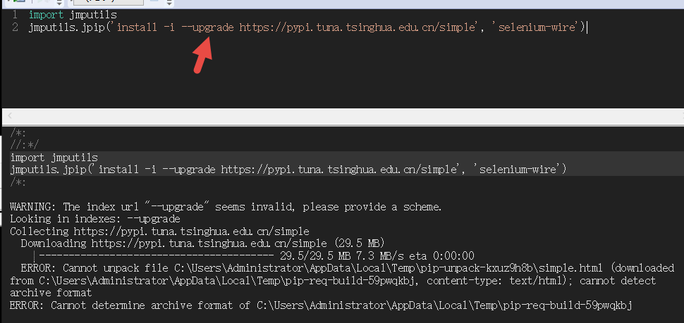

lala
Level IX
jthi
Have you tried dropping the --upgrade? Or moving it before -i (though I think it might be able to figure it out).
