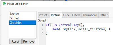

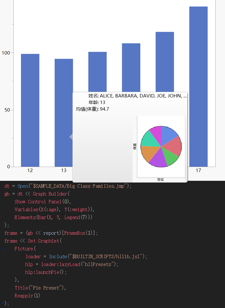

I love it to use the Hover Label framework to trigger an action.
option a) use "Click" to trigger actions via mouse clicks.
option b) use "picture" to trigger immediate actions once the mouse touches a data point (this is even faster than the generation of the hover label)
For me, the "Immediate action" was too uncontrolled - I started to move the mouse between the data points!
My final solution:
Stay with "Picture", so no click is needed.
But let the user press CTRL to trigger the action:
from Re: actions via mouseover ? - use a modifier Key :backhand_index_pointing_right::white_square_button...

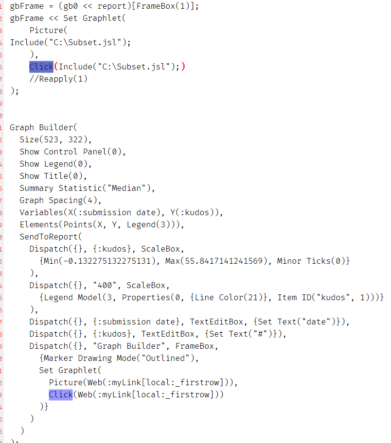

Against one of the expert's scripts to modify, or only click to trigger.
gbFrame = (gb0 << report)[FrameBox(1)];
gbFrame << Set Graphlet(
    Picture(
Include("C:\Subset.jsl");
		Click(Include("C:\Subset.jsl");)
    //Reapply(1)
Thanks!
