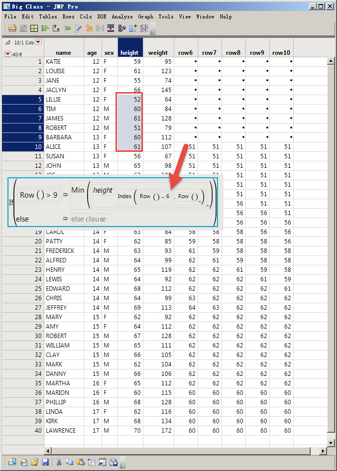

The requirements for calculation with the data of "Big Class.jmp" and formula are as follows:
Add column "row6" and find the minimum height from row 10 and up to 6 rows;
Add column "row7" and find the minimum value of the height column starting from row 10 and up to 7 rows;
How to find the result of "row6" -- "row9" directly by using memory array method?
Thanks!

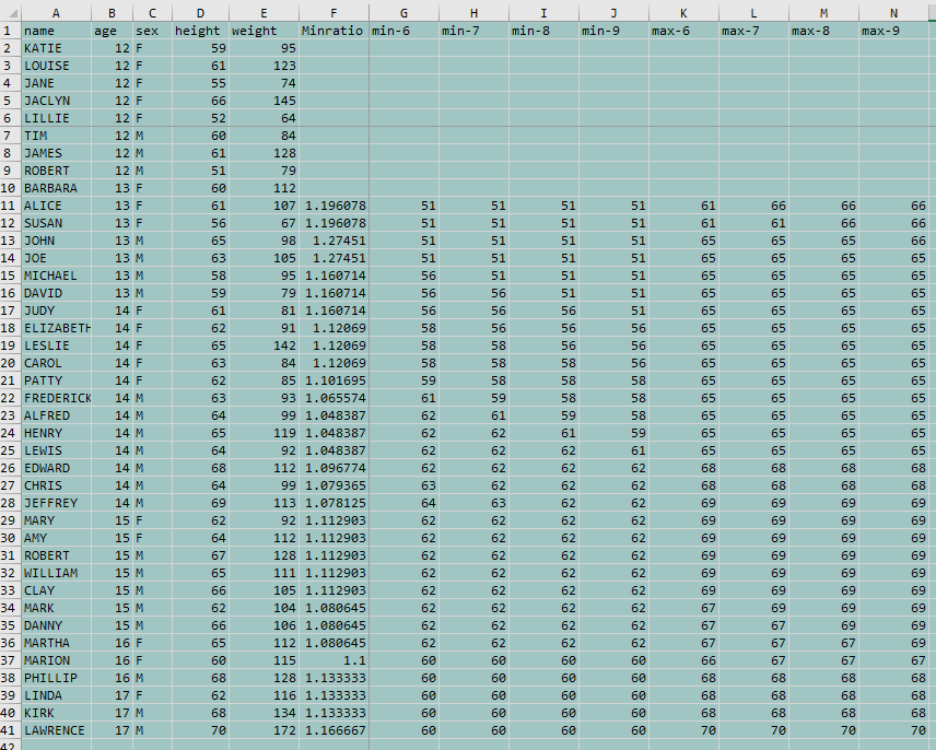

My actual calculation is:
1. Calculate the minimum value according to the above requirements.
2. Calculate the maximum value according to the same principle.
3. Put the maximum/minimum value of categories 6, 7, 8 and 9 respectively.
4. Select the minimum value of the four ratios
This outputs the minimum ratio of each row to the table.Other intermediate data is not output.
I wrote the code in Excel's VBA.

How do I change this VBA to JSL?
