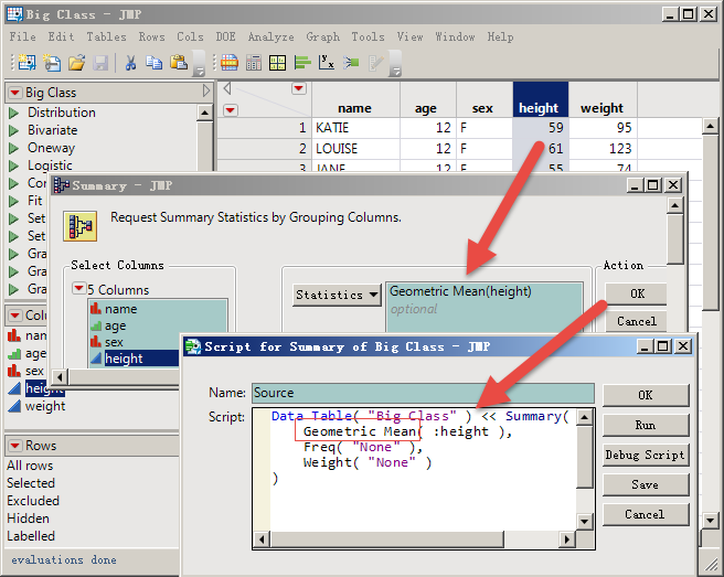

How can calculate the geometric mean of some rows?
The geometric mean can be easily obtained in Summary.
But how to calculate the mean by the formula column, right?
I searched the help documentation and the community and still couldn't find a way.

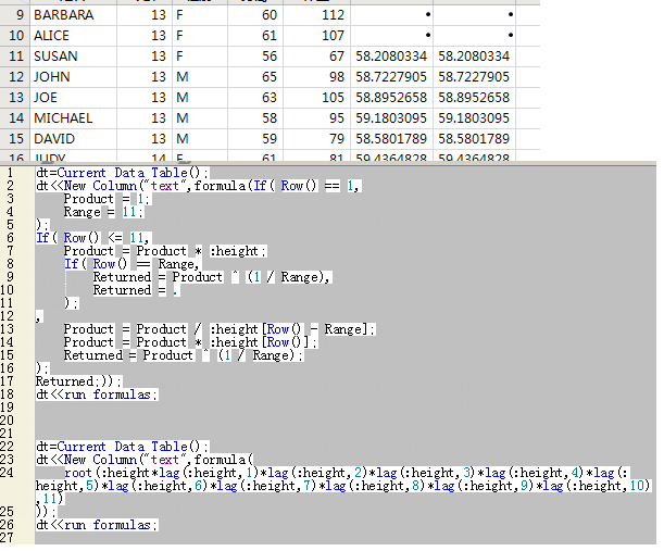

lwx228
Level VIII
Re: How can calculate the geometric mean of some rows?
I used the original method and the results were consistent.

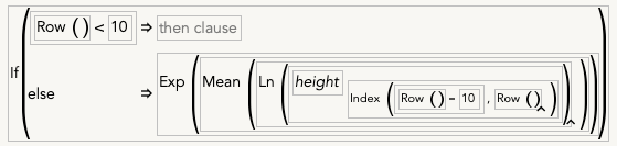

ron_horne
Super User (Alumni)
thank you @jules
i was attempting to do it all in one go but didn't get it to work as in this picture:

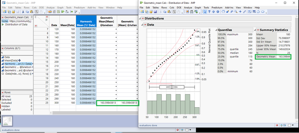

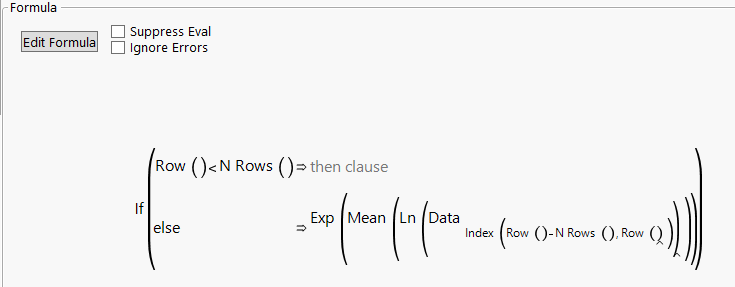

A useful strategy here I think is to use the "NRows()" function in JMP to call out the indexing on the row number if you're interested in the general Geometric mean calculation that is typically reported in summary statistics (and is the one that JMP reports under Customize Summary Statistics).
I was able to summarize (reproduce) two of the approaches used in this thread, and I am including the data table on a generic dataset for anyone's  future reference. cheers, @PatrickGiuliano
